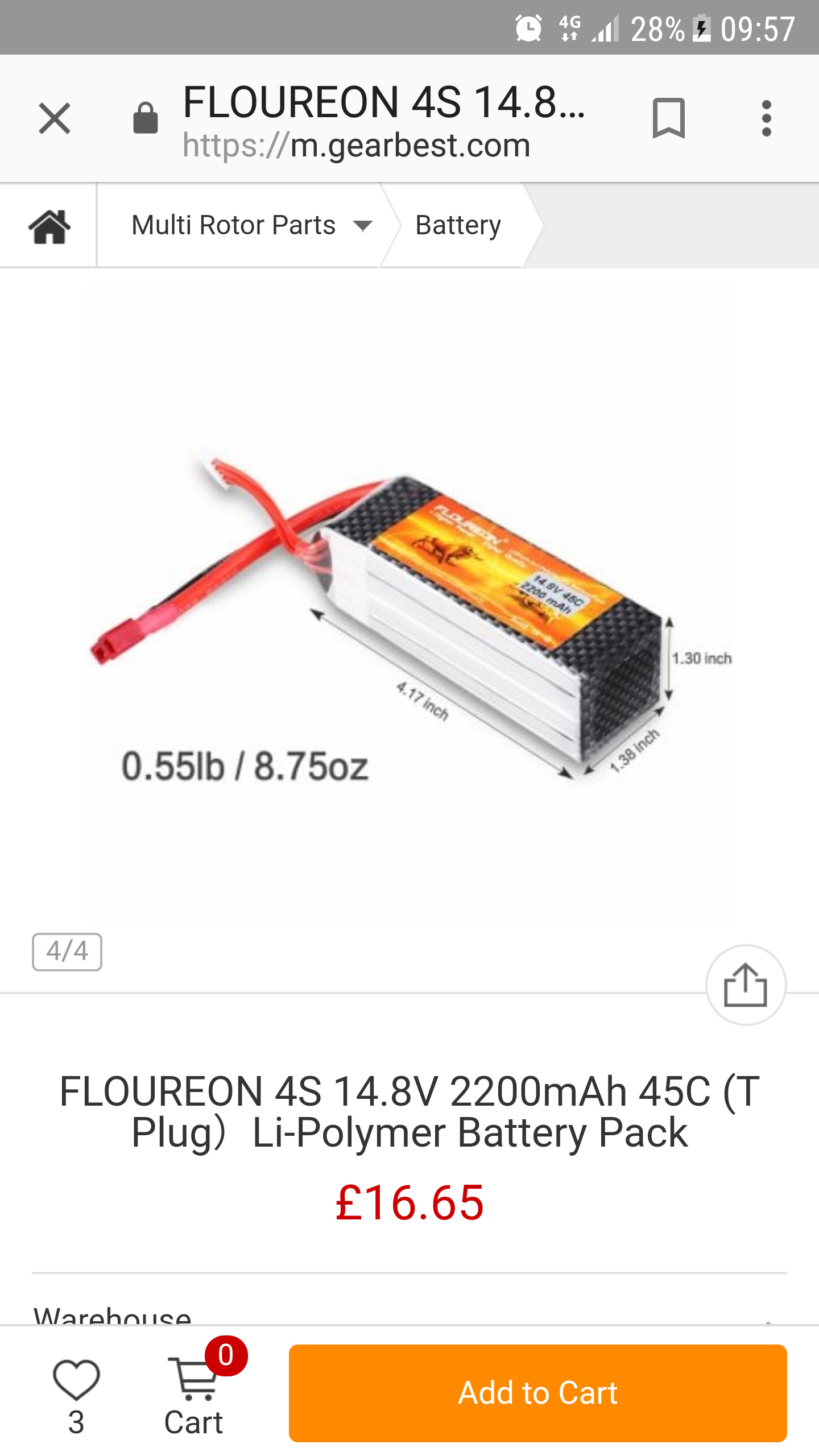

Would it also be possible to run each motor/esc with it’s own battery then?
Lets say a 2200mah 4s 40c lightweight battery or wouldn’t this idea be practicle?
I’m considering this as an option to limit costs also, as i think it could be beneficial on maintenance as if a cell broke down i wouldn’t have a massive cost associated with a high capacity battery. I could then just change out a £20 battery as opposed to a £100 + battery?
Yes that is entirely possible and could be a good idea if something did break, but you will need to connect all 4 batteries in parallel. The only thing is that if using them all isolated it gets hard to monitor the voltages for all batteries so this method probably increases the likely hood of over discharging a cell. This is because each motor does not use exactly the same amount of battery during a flight. At-least if they are in parallel, this issue is mitigated somewhat.
