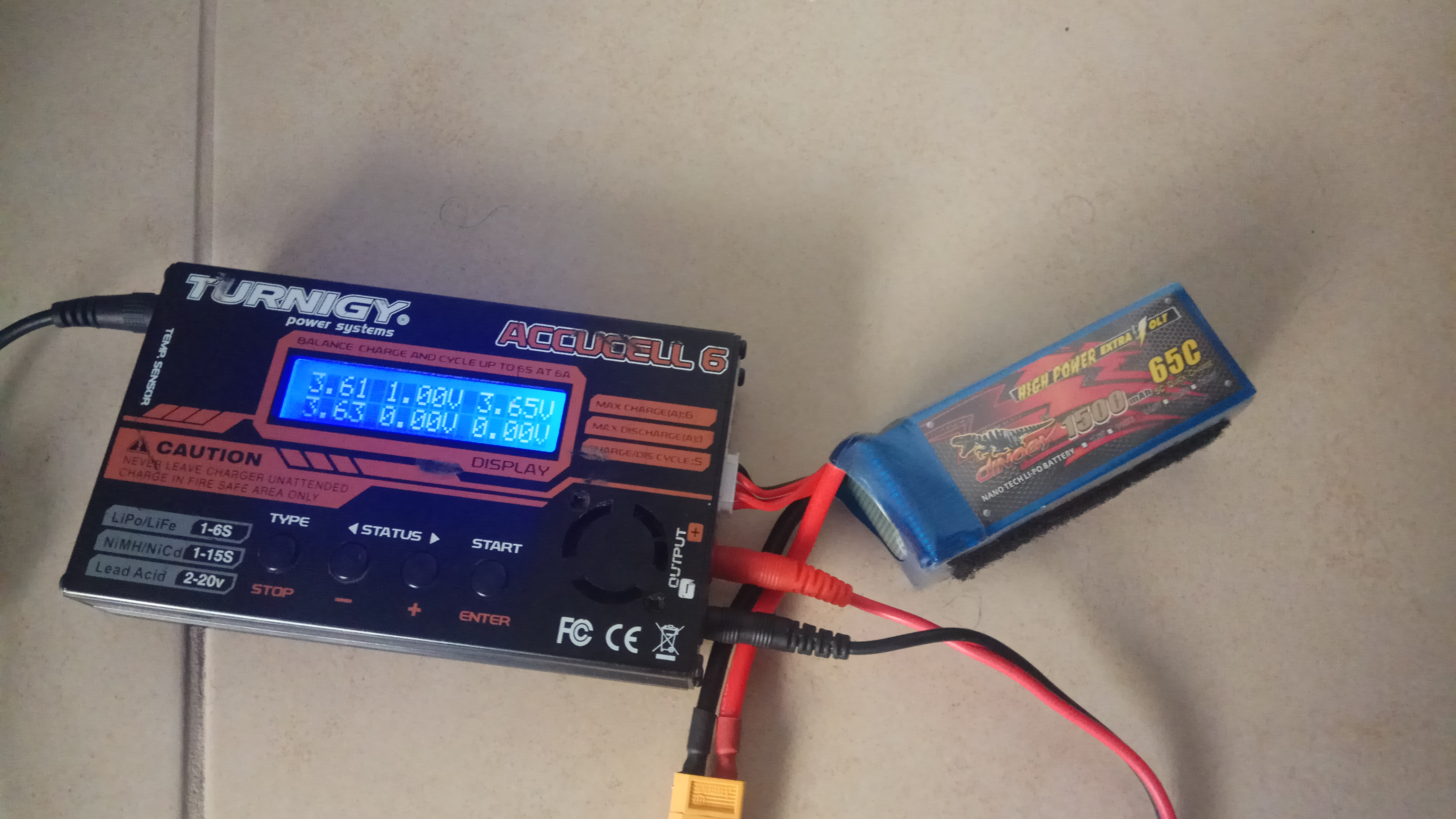

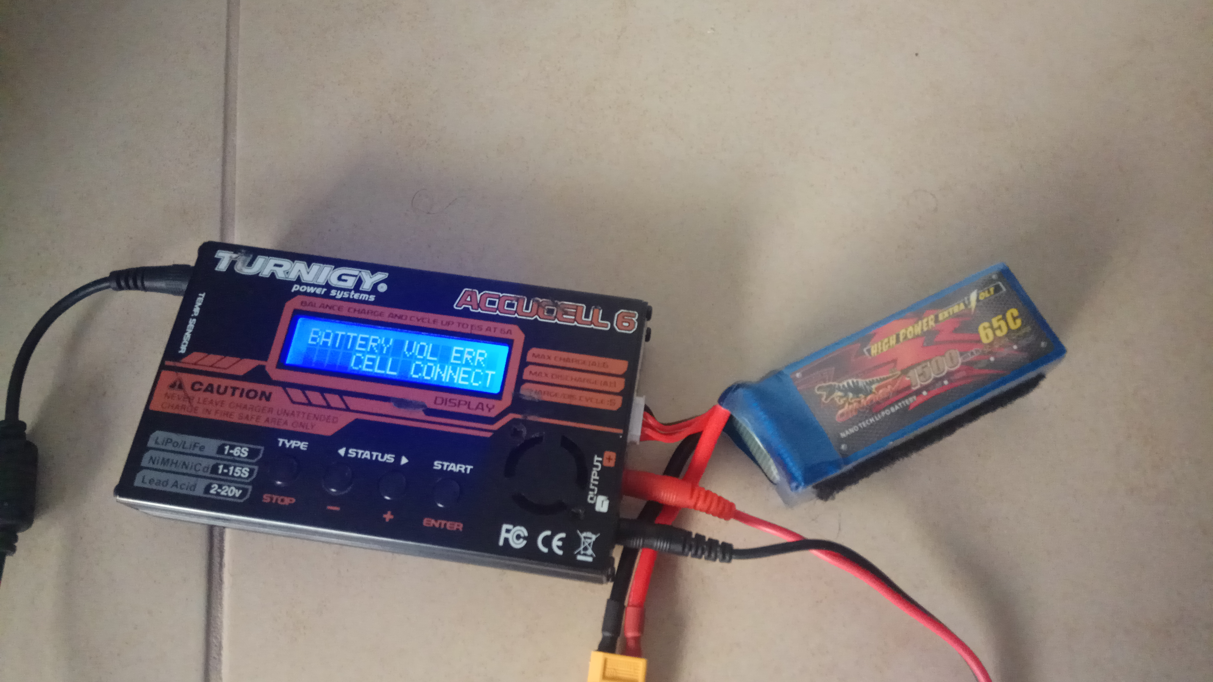

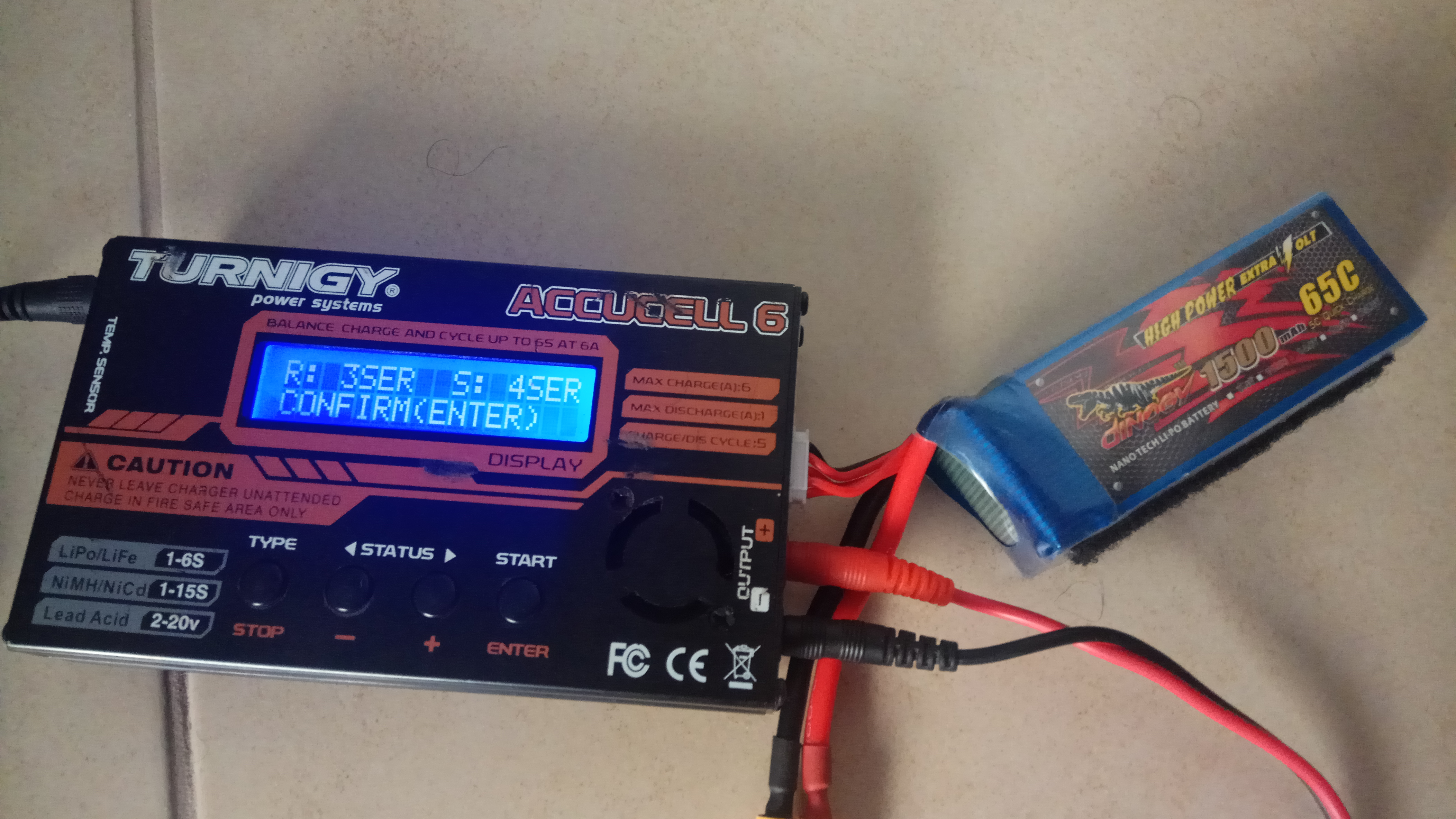

I’m using my friends Turnigy Accucell 6 charger to charge my new battery, its a 1500 mah 4S battery, I already charged it a few times but now when I try to charge it, it says voltage low, I charged it a little with Nimh charge and its on 10v it shows, I do LIPO balance charge and it shows its a 3S batt and when it starts to charge after a few seconds I get BATTERY VOL ERR CELL CONNECT and it stops charging,I press to see the details and the volts are 3.65V,3.62V,3.63V,1.03V, what to do? I’m afraid that it will blow or something.

Probably one Cell is damaged.
Looks like you have a dead cell.
Its more of a danger when you try and charge it.
At the moment the other 3 cells are at a safe voltage.
Will the cell being that low, I won’t try to recover it.
If you do try… Then do it outside and as safe as possible. You don’t want it going up in flames in your home.

I just tried to check the batttery on my drone and it worked for about 10 minutes but I didnt have the same power.
Now it can be balance charged but it detecs 3cells again, usually after 10 mins the charger says:" VOL SELECT ERR", and it doesnt show the voltages of all the cells.
