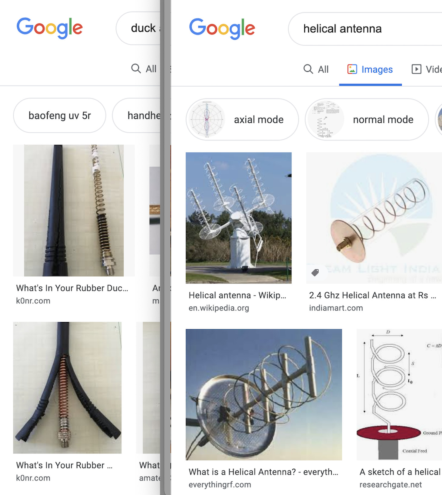

The duck and helical antennas seem to have the same structure, just duck is long and thin while helical is short and wide. In the following screenshot the internals of the two are side by side.
