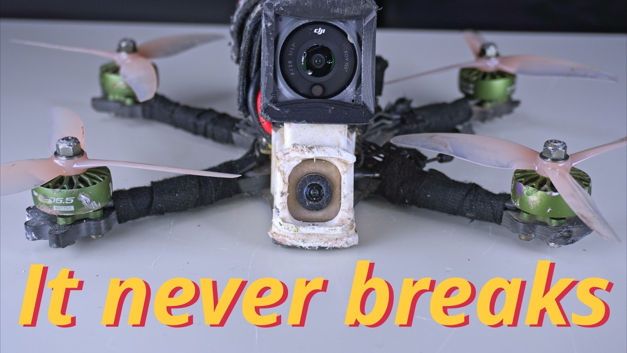

Nils Vo has kindly distilled years of trial and error into three simple rules for creating a freestyle quad that’s more resilient than your average builder’s tea. It boils down to this: invest in quality frames and motors, tuck away those delicate bits deep inside the frame, and for goodness’ sake, check your screws regularly—every 3 to 5 packs for main arms and every 5 to 8 for motors. You’ll spend less time tinkering and more time flying (what a novel idea).
The beauty of these guidelines? They’re practical and don’t involve a second mortgage on fancy TPU bumpers or a wildly elaborate aesthetic. If you’re the sort who can confidently plough through 15 to 20 battery packs in a session, these tips might just spare you the agony of constant repairs. Conversely, if you’re attached to a more ‘overbuilt’ look, well, perhaps do indulge in a bit of TPU; no one’s judging.
Remember, it’s not just about slapping together metal and carbon fibre; it’s about understanding where to splurge on quality and where to hide things from certain doom—like cameras, antennas, and that power connector that always seems to attract the worst kind of accidents.
