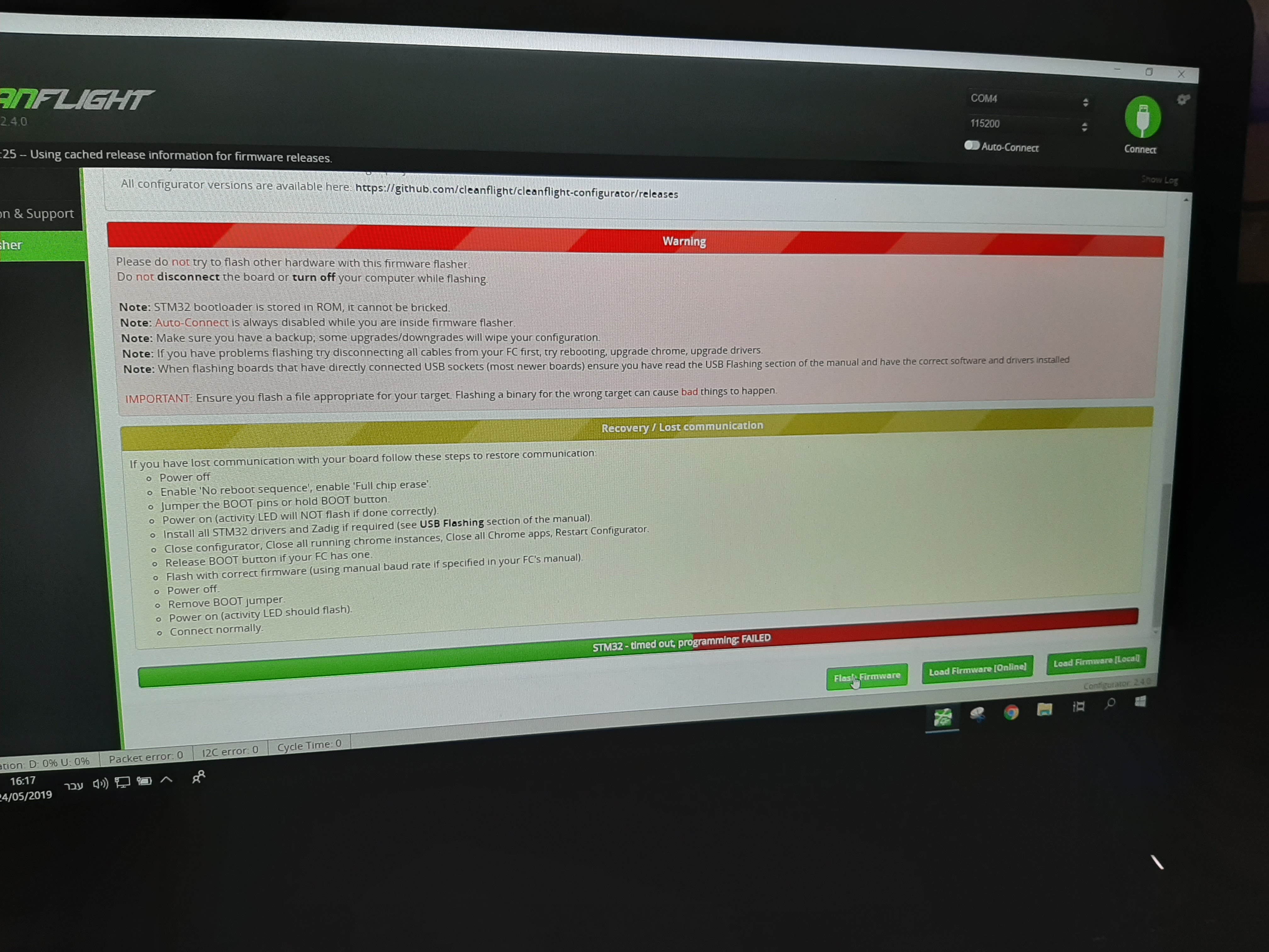

Stm32 timede out problem
Hi i just got naze32 full version and I’m trying to flash it in cleanflight and can’t there is problem with the stm32 timed out please help i tried everything zading impulserc i download all stm that i found

Basically naze32 board has not been supported for over a year now on betaflight so I suggest you upgrade to a newer stm32 f4 based board. Something like the omnibus f4 is a nice cheap board.
Otherwise try to use the impulserc driver fixer and an old version of betaflight

Try programm - Demonstrator GUI. Here ( https://www.youtube.com/watch?v=9wwQZPGugoc ) guy save my old Naze from “stm32 timed out programming failed” . This video is how to fix BRICKED BOARDS but it’s help me to fix stm32 timed out problem :wink:
Hi, i had same issue. I was able to resolve it by following Youtube video shared by @Kid
Though i’m not able to flash latest firmware version. v2.2.0 is working for me.
Yep! For me the latest firmware dosent work too, but it dosent matter ))
