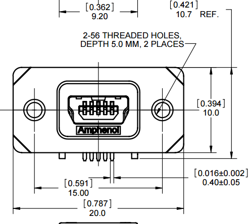

Screw size for Pixhawk Peripheral kit/ external LED and USB?
Need the screw size for the Pixhawk external LED and USB kit? Please see the attachment on this document for all the dimensions and sizes that you could possibly need for this accessory to the Pixhawk flight controller.
musbb151.pdf (89.3 KB)
