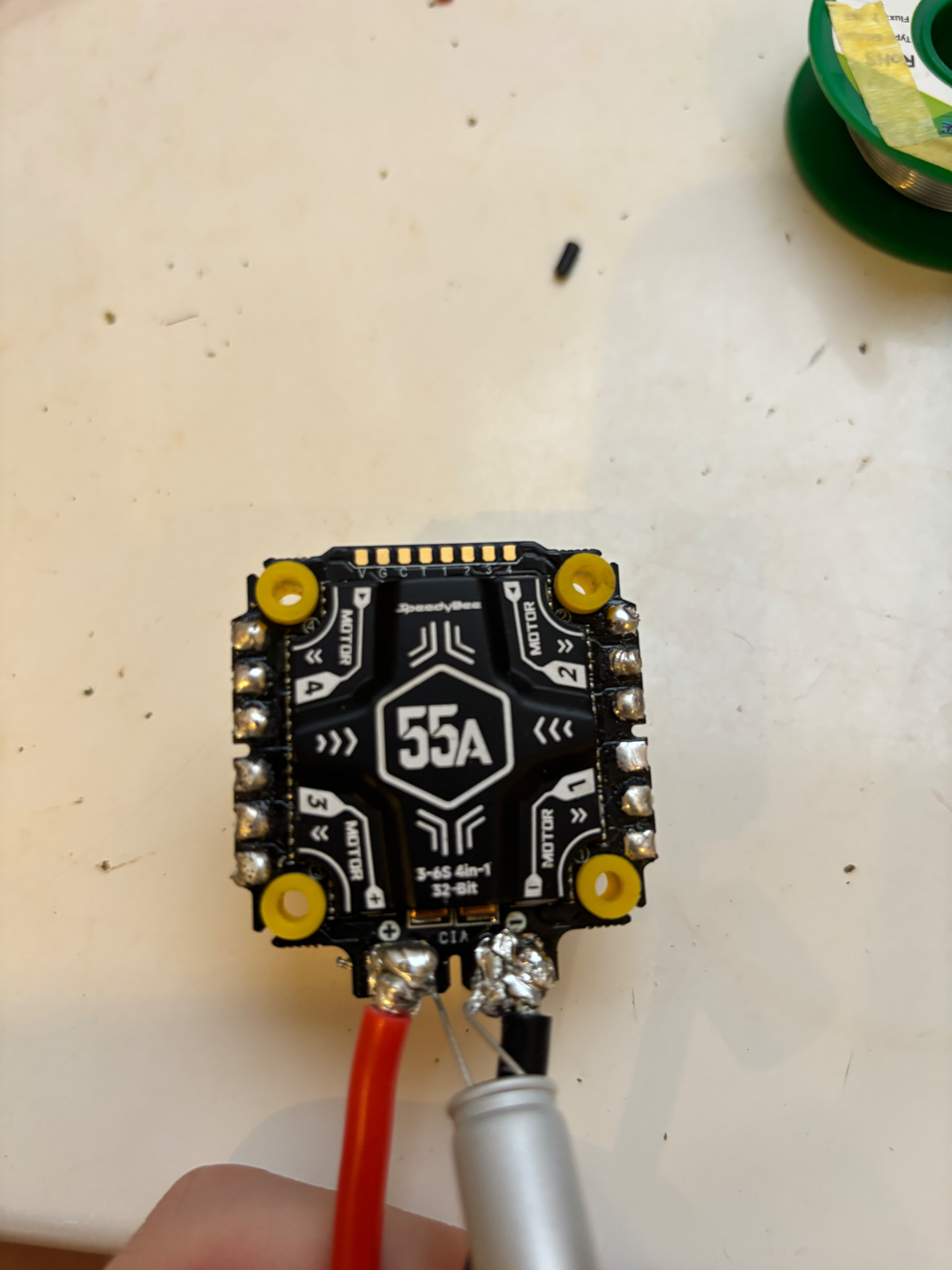

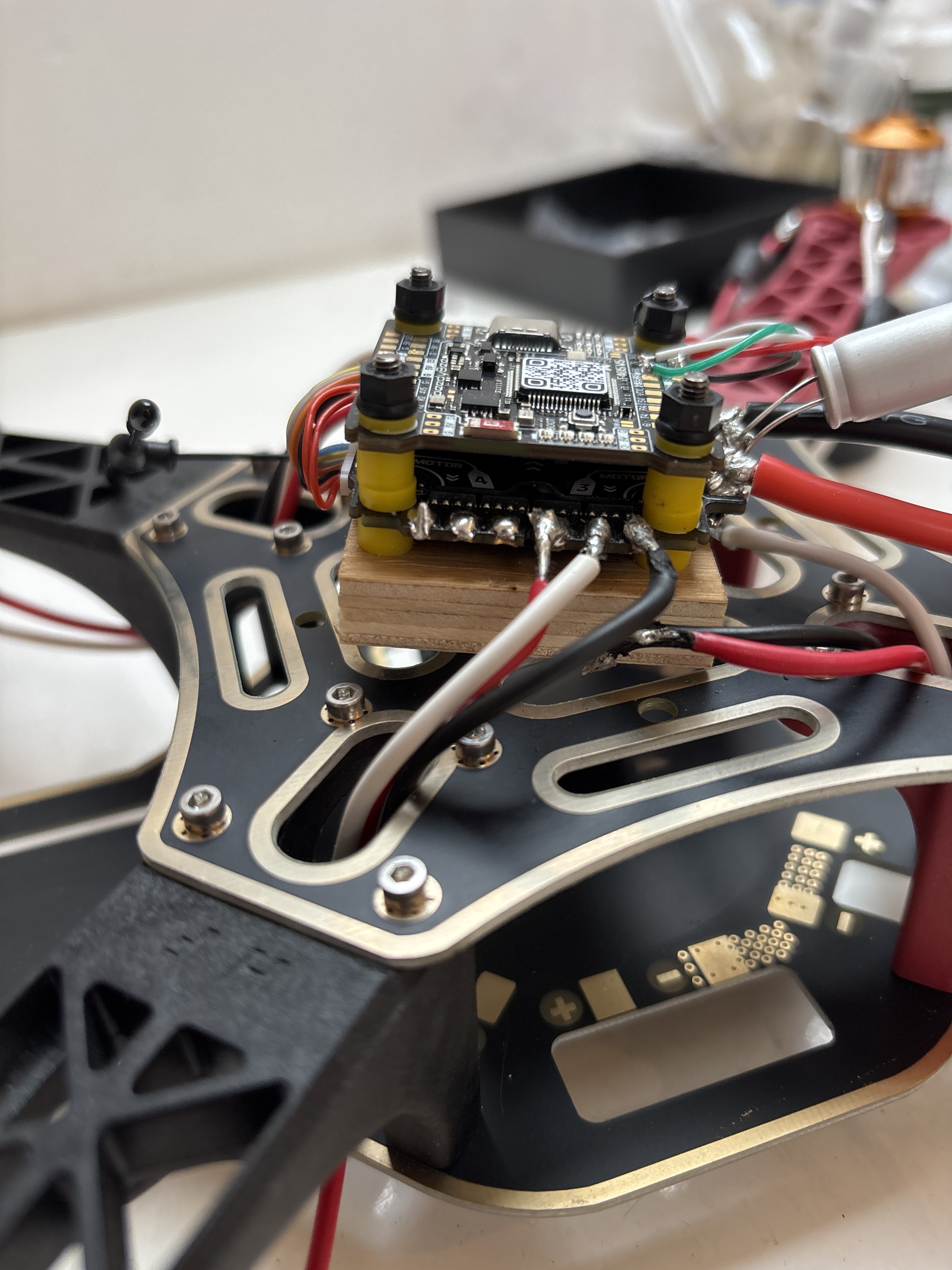

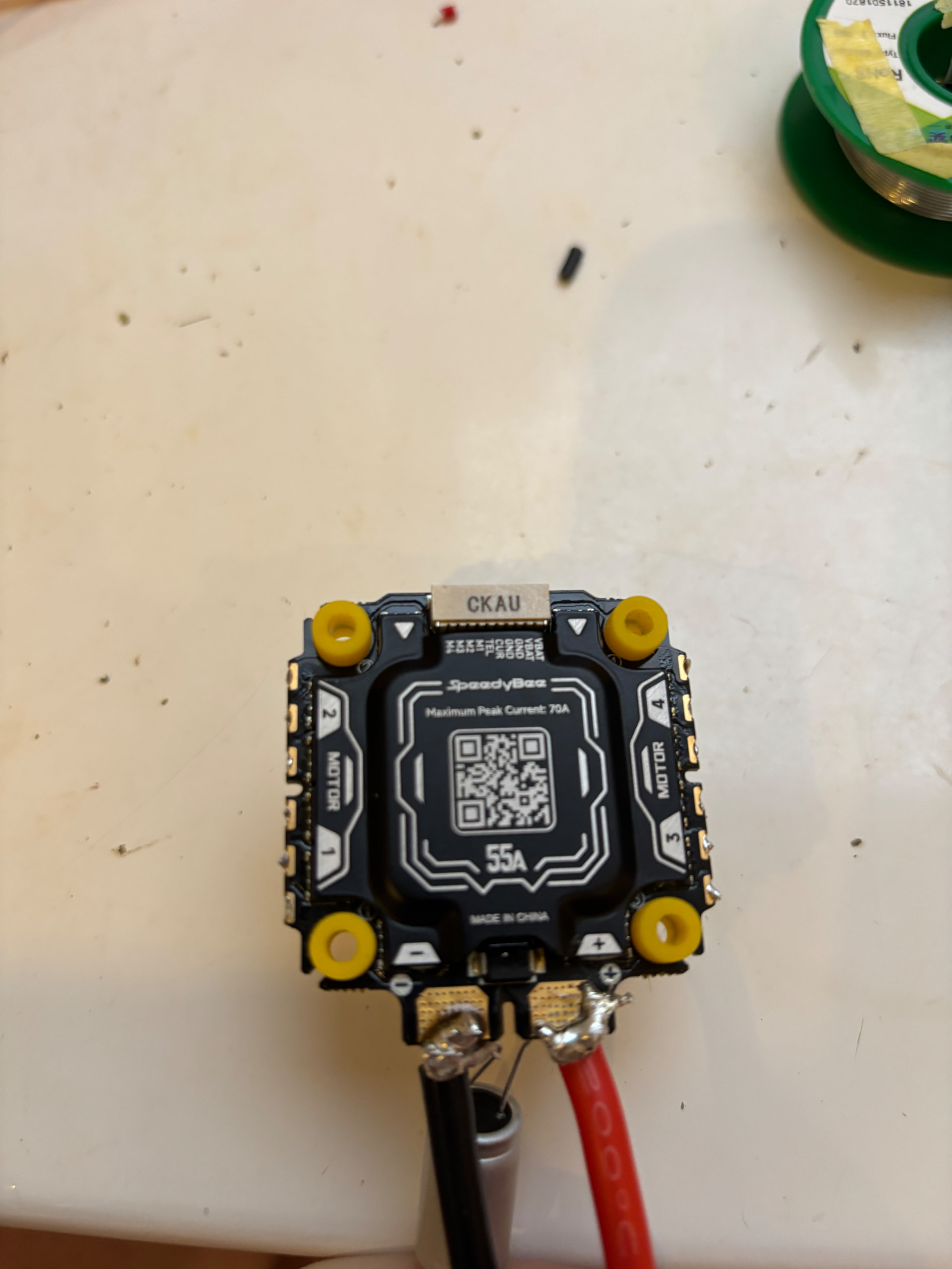

Hi Alex,
Thanks for getting back to me so quickly! I can’t see any visible damage on the esc but it does have a plastic cover so they are not all visible. The cover doesn’t feel like it would come off easily. Unfortunately I don’t have access to a multimeter, but here are the pictures.
Let me know what I can do next to resolve this.
