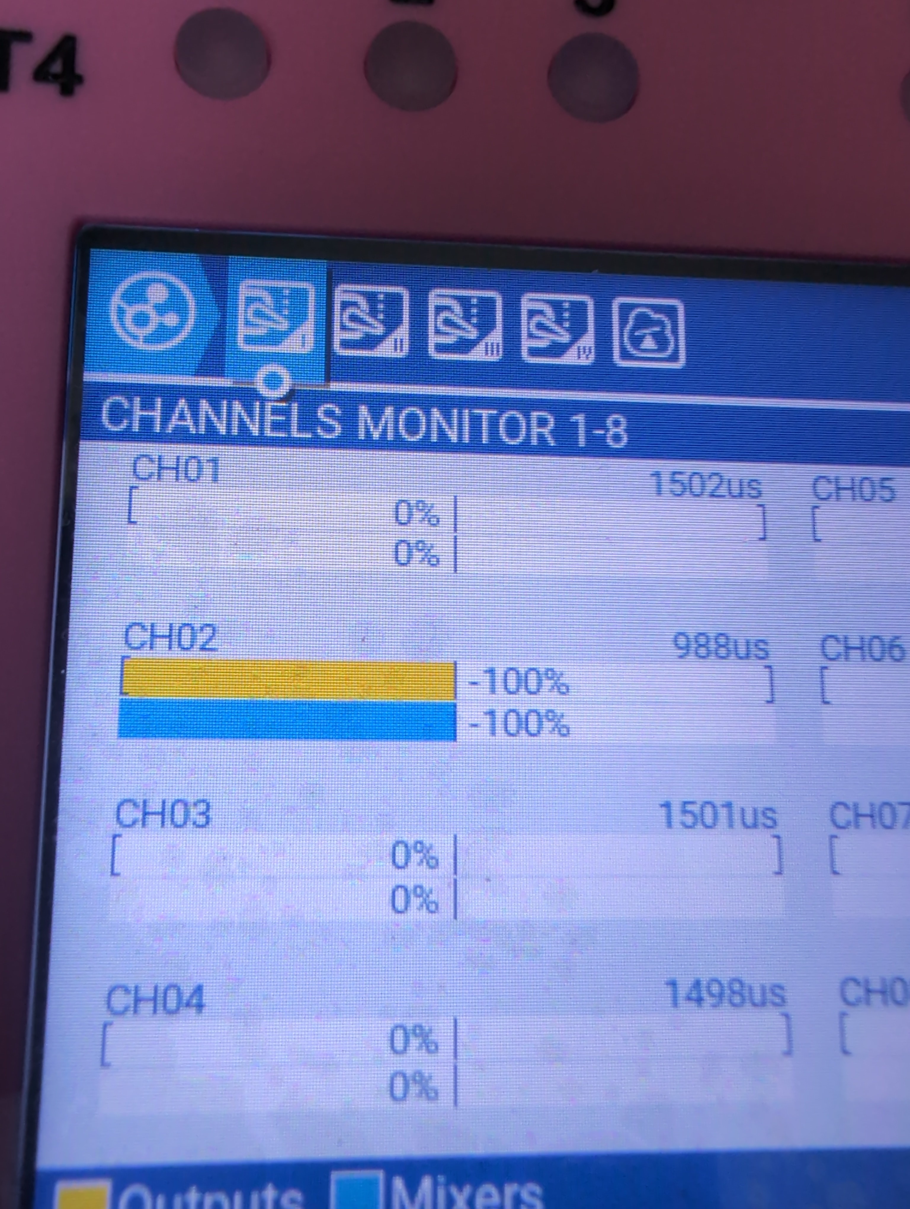

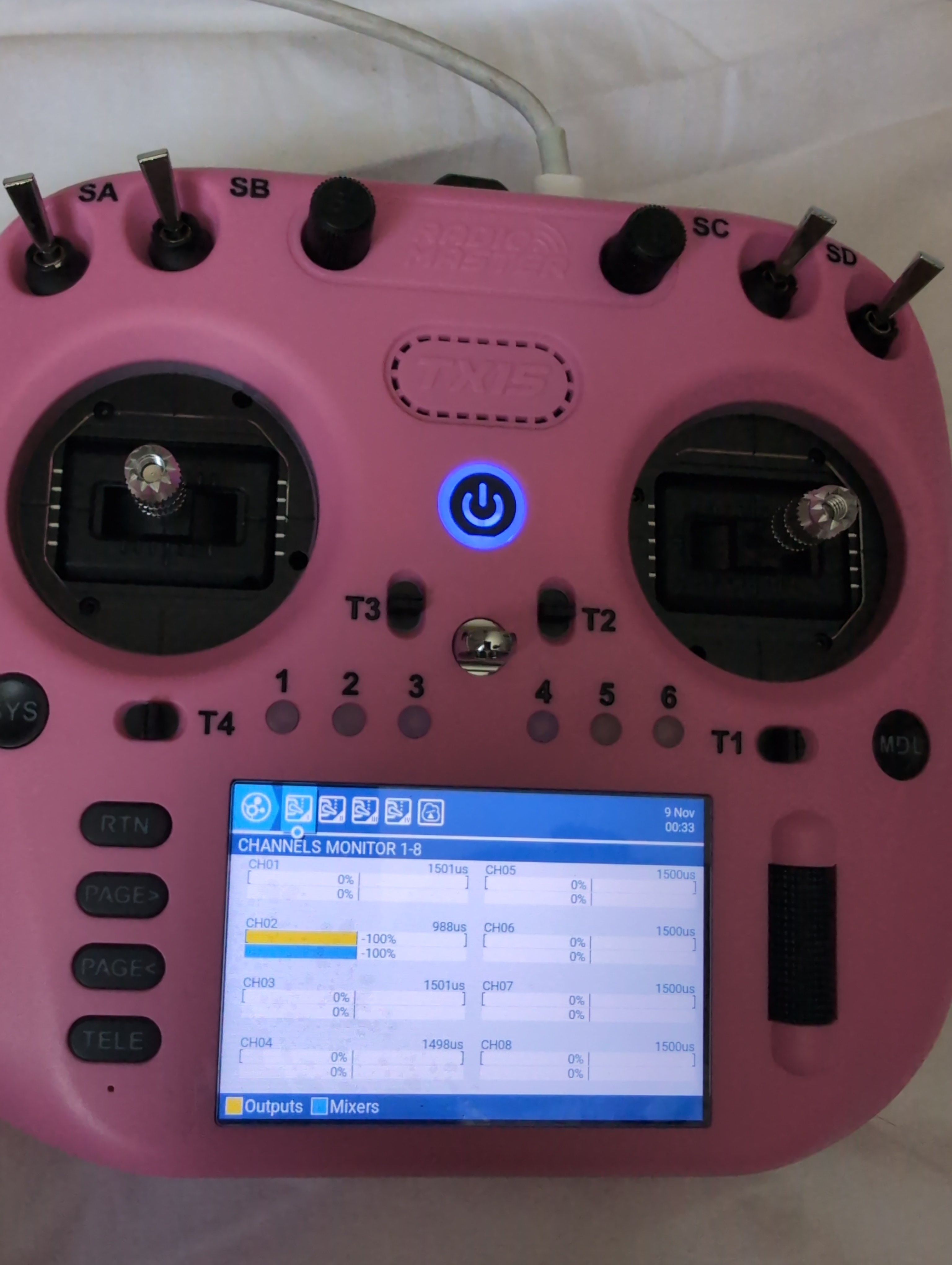

The right hand gimbal does not register up and down movement.
I have interchanged the gimbal with the other side and the fault follows the gimbal. The gimbal is faulty.
