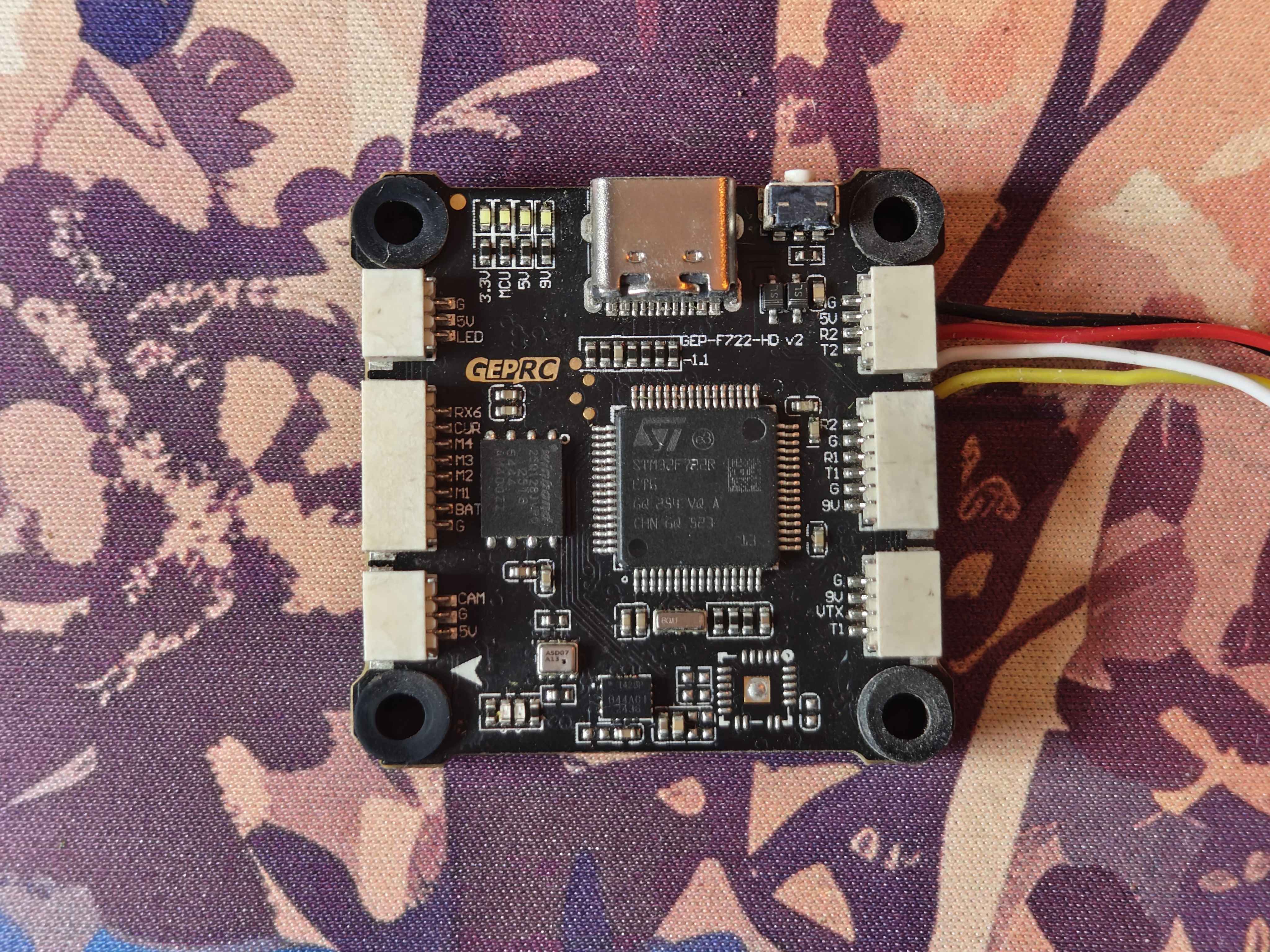

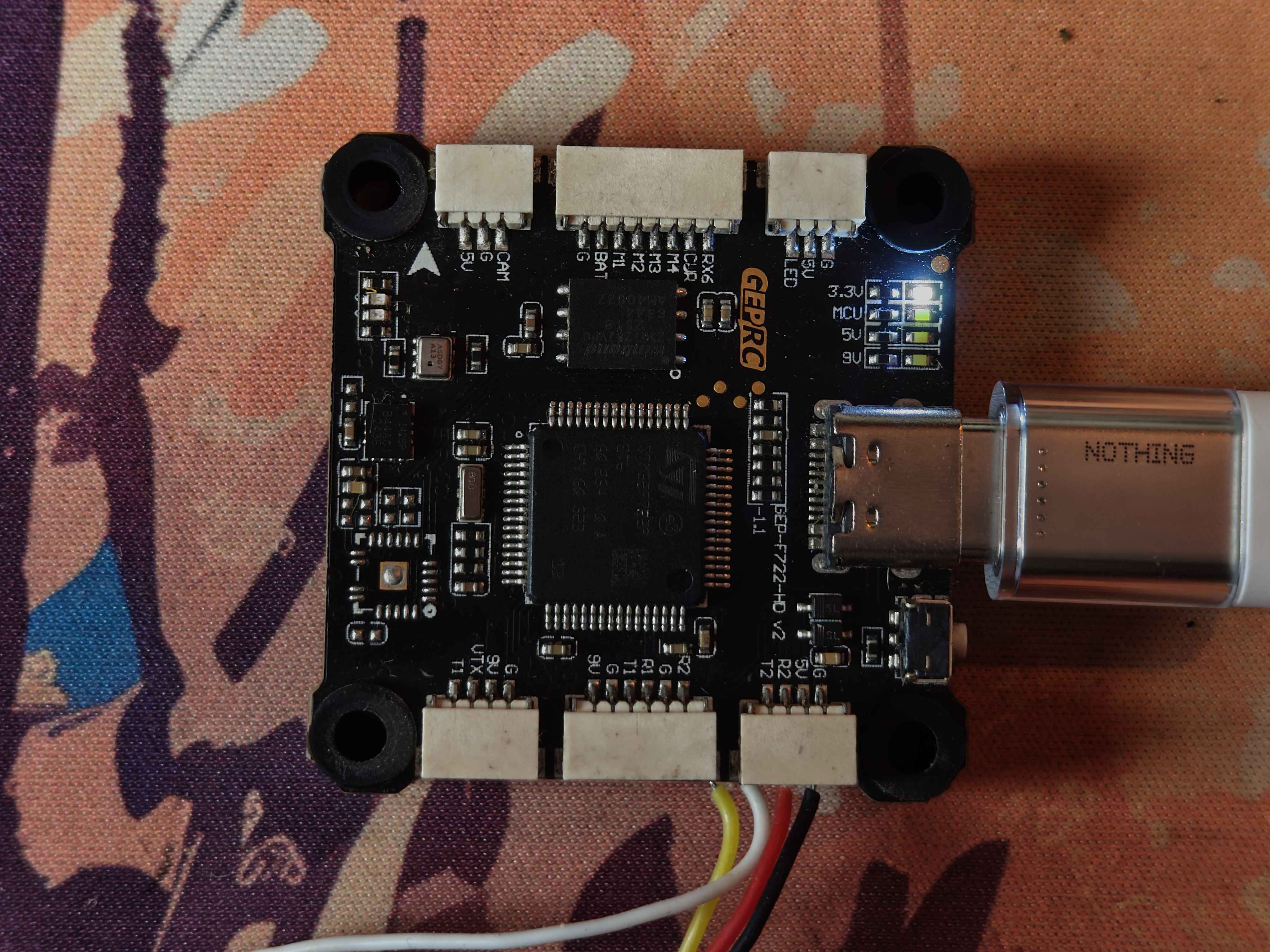

MCU on flight controller is dead, tried cable to phone, cable to PC and no device can be found. drone wont arm, no OSD in goggles, and no MCU light on FC regardless of power source (battery or USB). all other rails are working, such as 3.3v, 5v, and 9v. attempted different ways of powering and entering UFI mode with no life.
Also swapped the flight controller out for a brand new one and the ESC seems a bit off too, with vibrations in normal flight on a regular tune and all else tight and checked.
Different power sources, reseating connectors, different cables, UFI mode, cleaning board, checking for hot spots/shorts (MCU is cold to touch), powering with no components connected.

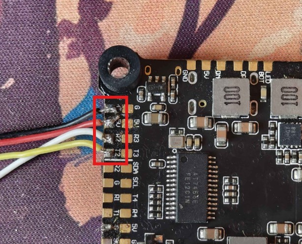

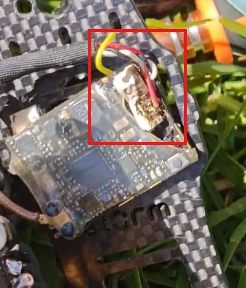

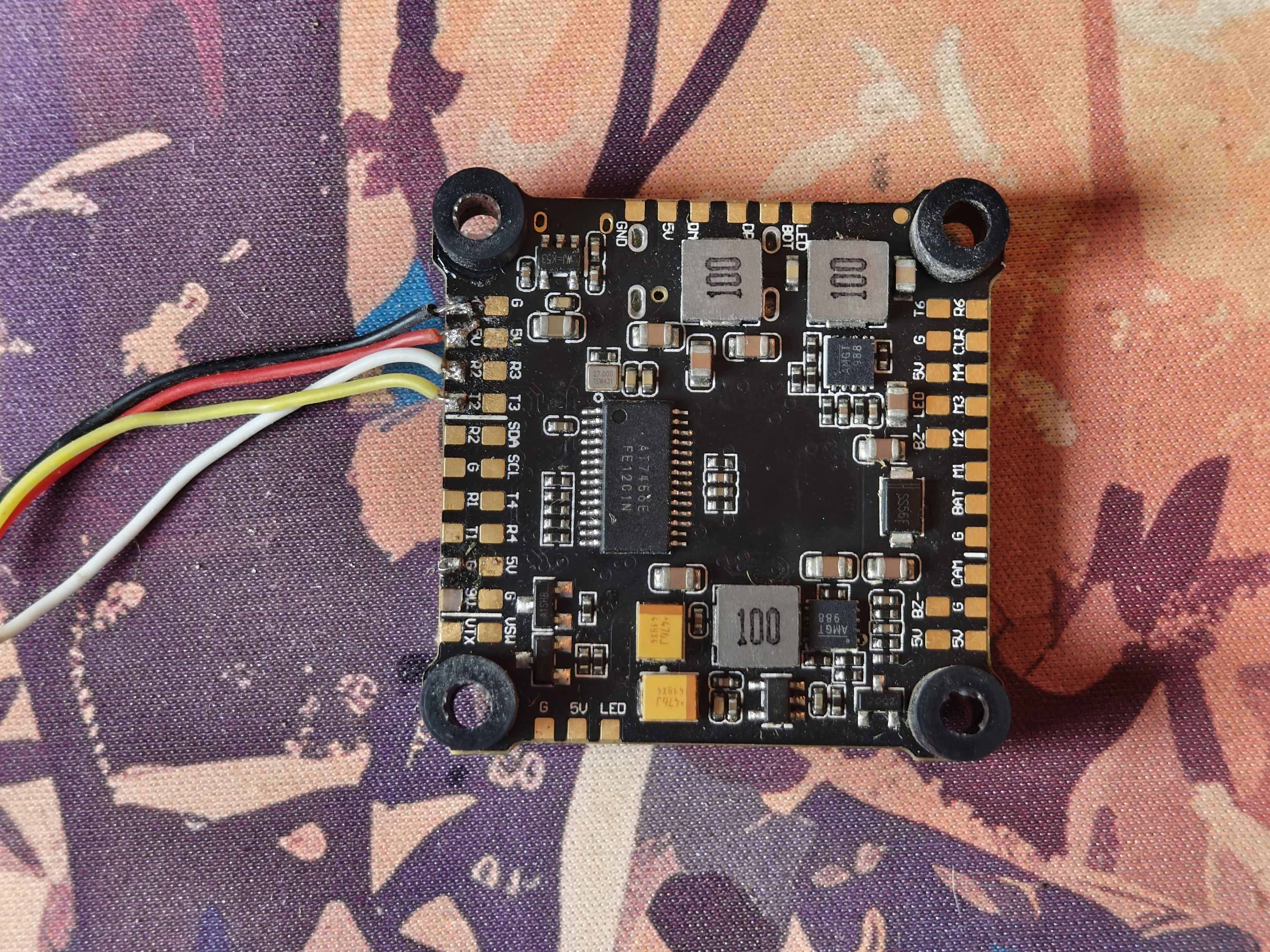

Looking closely at the setup, the VTX connector appears to have melted or shorted. There is also some exposed wire on a few of the flight controller solder joints. Since the board flew successfully before stopping, it is highly likely that the VTX connection caused a short.
