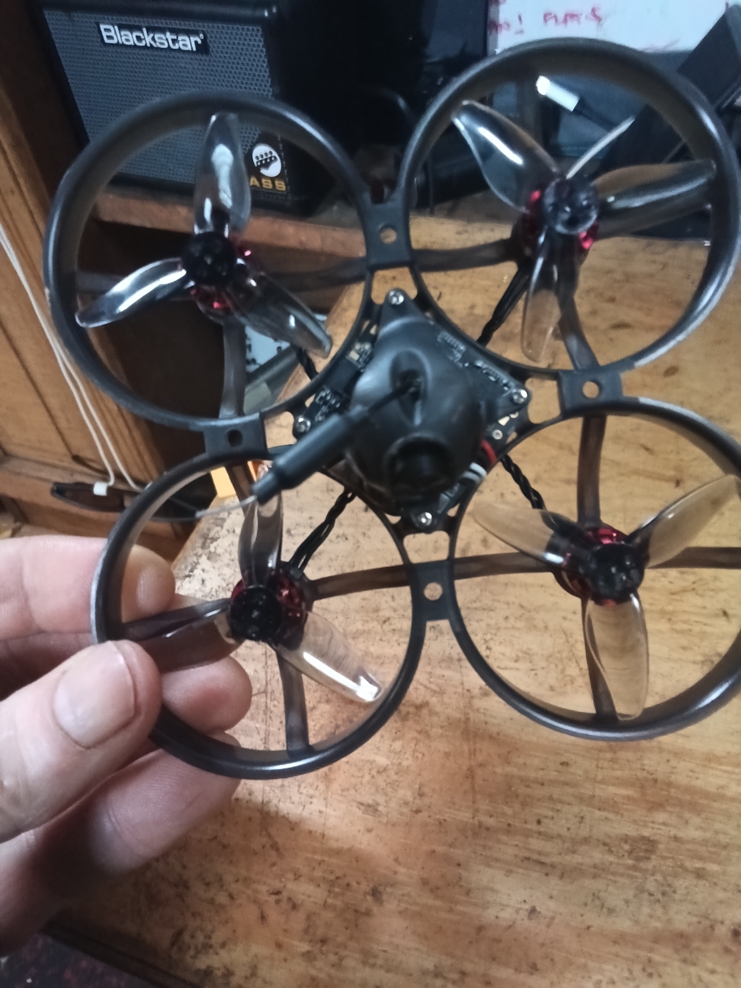

Cannot bind drone shows green flashing light on startup recognised as camera connection faulty.
Flashed latest firmware to drone and goggles avatar hd L
Could you please clarify what you mean by you cannot bind drone… Is this you cant bind your drone to your ELRS radio, or you cant bind the goggles to the VTX?
Either way please confirm what firmware you have loaded onto the FC / VTX / Goggles / Radio etc.. so we can further help you to diagnose the issue as its most likely a configuration mismatch causing this.

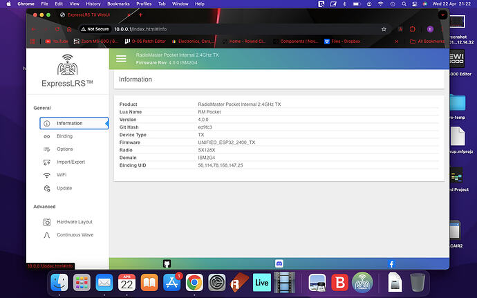

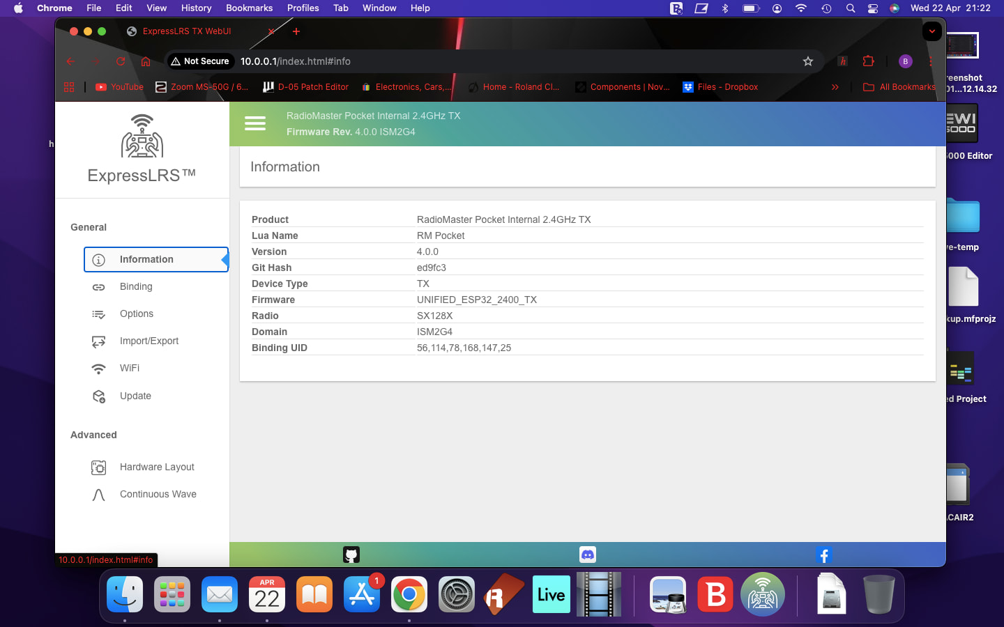

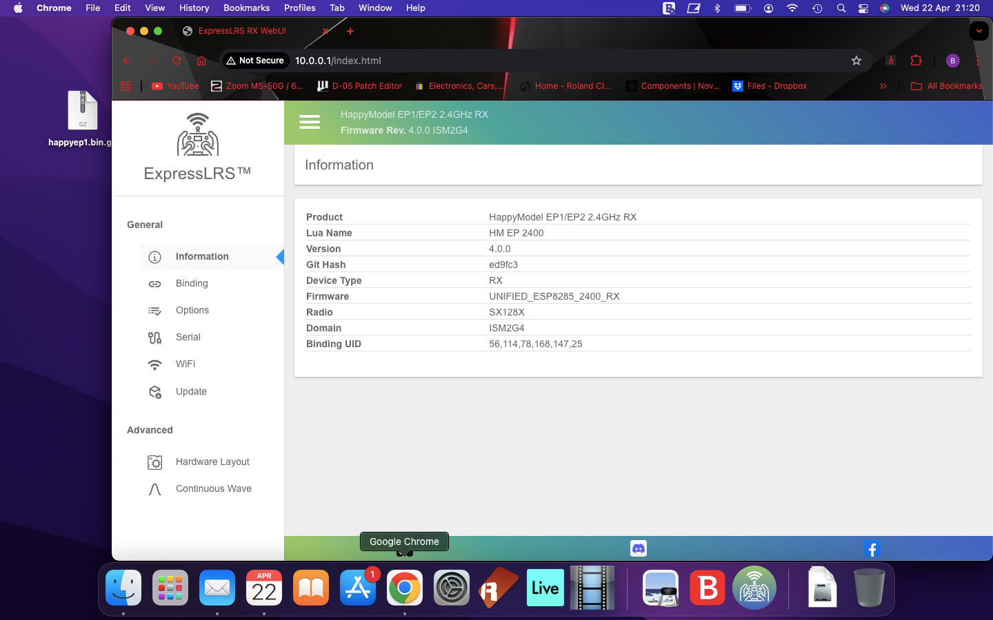

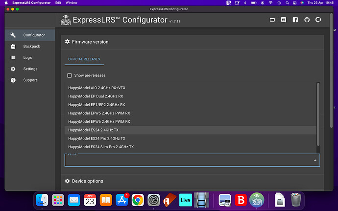

screenshots elrs info
the controller is connected to receiver but is not responding to any joystick input.

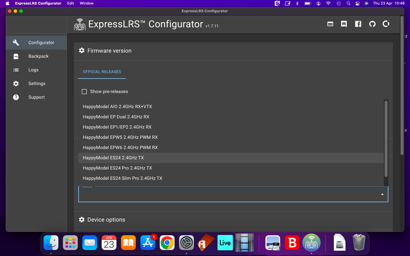

Here is the firmware available for happy drone 2.4
Hi Bob,
Thanks for sharing that screenshot — I can see you’ve pulled up the list of available firmware versions for the HappyDrone 2.4 RX in the ELRS Configurator. Good to know you’re already connected to the receiver via WiFi!
Before we go any further, could you tell me: what firmware version is currently showing as installed on the receiver? It should be displayed at the top of that configurator page (something like “Firmware: v3.x.x”). This will help us check whether there’s a mismatch. I recall that the module 8 ships with ELRS V3.xx on it. Best to connect to the ELRS page via WIFI if you can as you can then confirm the firmware target, but according to docs it should be HappyModel EP 2400 RX
That said, I want to refocus on what’s most likely causing the “connected but no stick input” issue:
Also still worth checking — Betaflight Receiver tab once you have bound the RX:
Plug your Mobula 8 into your PC and open Betaflight → Receiver tab. Let me know what you see:
  • No bars at all → FC isn’t receiving data (UART/protocol issue)
  • Bars visible but don’t move with sticks → almost certainly Model Match
  • Bars move but on wrong sticks → channel mapping issue
Updating the RX firmware to a newer V4 version that matches your radio will resolve the issuce since ELRS v3.x is backward compatible within the major version, Or you could downgrade firmware on your radio to V3.0
Kind Regards,
Unmanned Tech Support
screenshots show both on elrs 4.0
sorted betaflight issues reinstalled original firmware from happymodel via cli dump and it came to life.
