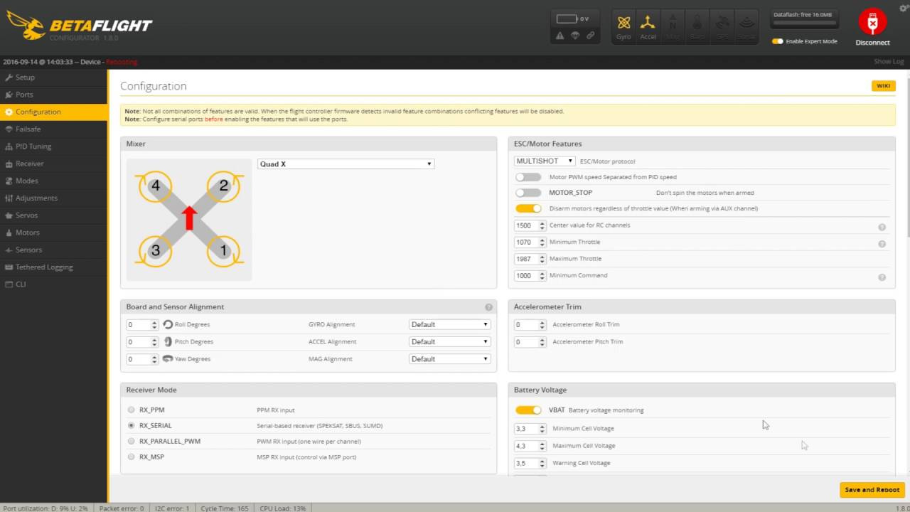

Glad to be in the group. I’m trying to set up a 350 hex with Inav on the Omnibus F3 V1.1 and have an issue with motors 5 and 6. Only 1-4 show up. I’m seeing somewhere that pwm 5 is used for leds. What’s that all about? Is there a way I can map pwm 5 and pwm 6 to be what they’re supposed to be, motor pins?
can you change the drop down box from Quad X to Hex.
Then click Save and Reboot
Yes, I’ve checked off hex X. I’ve solved the problem. Seems if there’s anything connected to uart 6 then pwm 5 and 6 are reassigned to another function. Seeing as uart 6 the traditional connection for the receiver I had to switch the receiver to uart 1. Gnd, rx, +5v. If uart 6 is left empty all motors show up. So, if you’re building a hex you only have 2 available uarts, uart 1 for the receiver, uart 2 for GPS, and of course i2c for compass. Uart 6 must be left unassigned in Inav. I suspect this is true in Betaflight and Cleanflight as well although I haven’t tried those. Hope this helps others trying to build a GPS hex in Inav. It took some digging to discover this.

Hi. I’ve got a problem. Im using this FC and a FlySky i6 transmitter and also a Fs a8s receiver. Im in Betaflight 3.0.1 version and when i want to go to the receiver section my receiver tabs doesn’t move. Also when i go to configuration and i select the receiver Ibus when i save and reboot then, automatically it says spektrum receiver instead of ibus. I dont know how to solve it and i have activated the serial rx in UART 3 . Can someone help me? Thanks
I suggest you move to a more recent version of betaflight, and also use a correct version of of the betaflight GUI, as you need to use a gui version that is from a similar date to when the firmware was released to ensure it is compatible.
