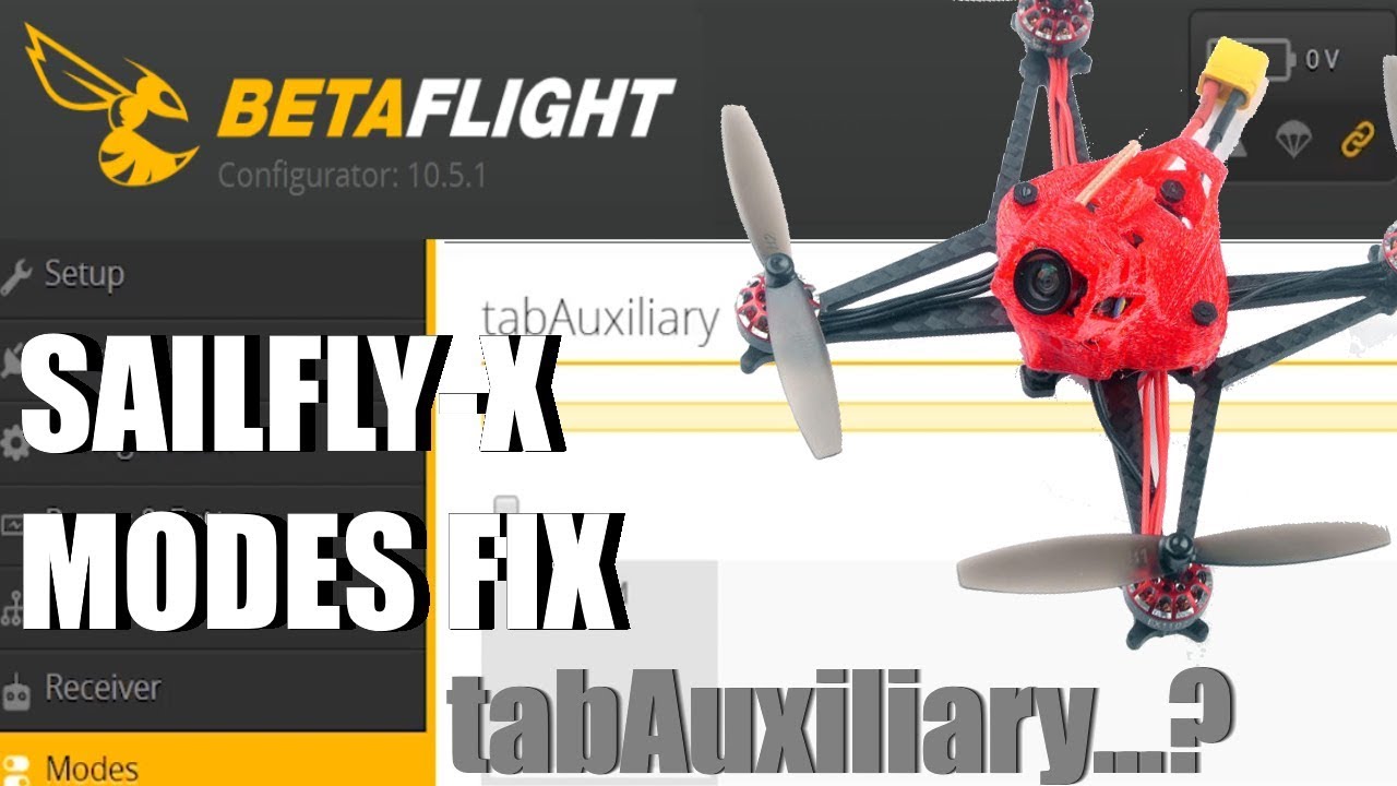

Hi this is now solved, it was purely a firmware & BF issue.
I did not use the manufacturers updated ‘Diff’ CLI command & matching correct board firmware version:
Once I followed the steps in this video, the problem was solved…
Thanks again @dale589 for your prompt help!
