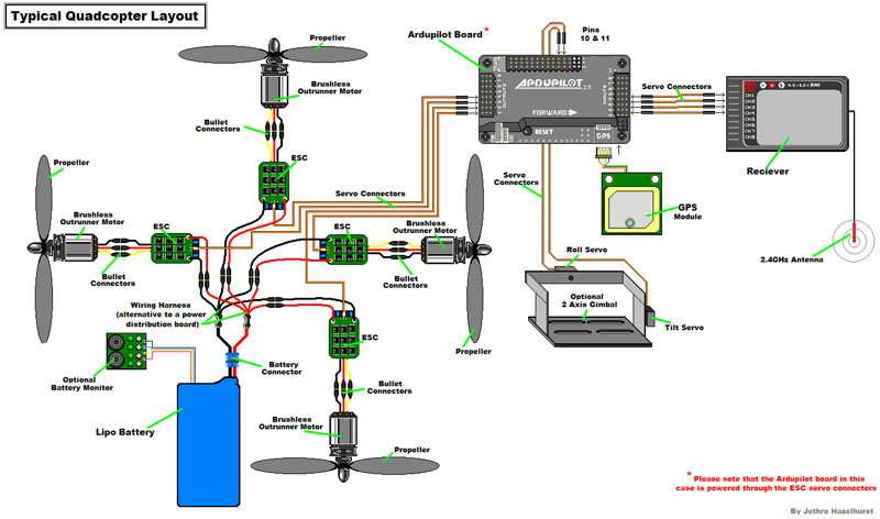

hi I wonder if I could show some scheme to set up a connection with APM 2.8 and neo telemetry module gps 6m for QRX 350 pro thank you very much
This image should help:
I am nut sure what Neo 6M module you are using but if it has a built in compass you will need to connect the GPS connector the GPS port, and then the 4 pin compass connector the the I2C port on your APM.
hi thanks for your quick response, I have only two questions, as I connect the battery sensor and telemetry OSD for? I have to take food also for the receiver? thank you very much
