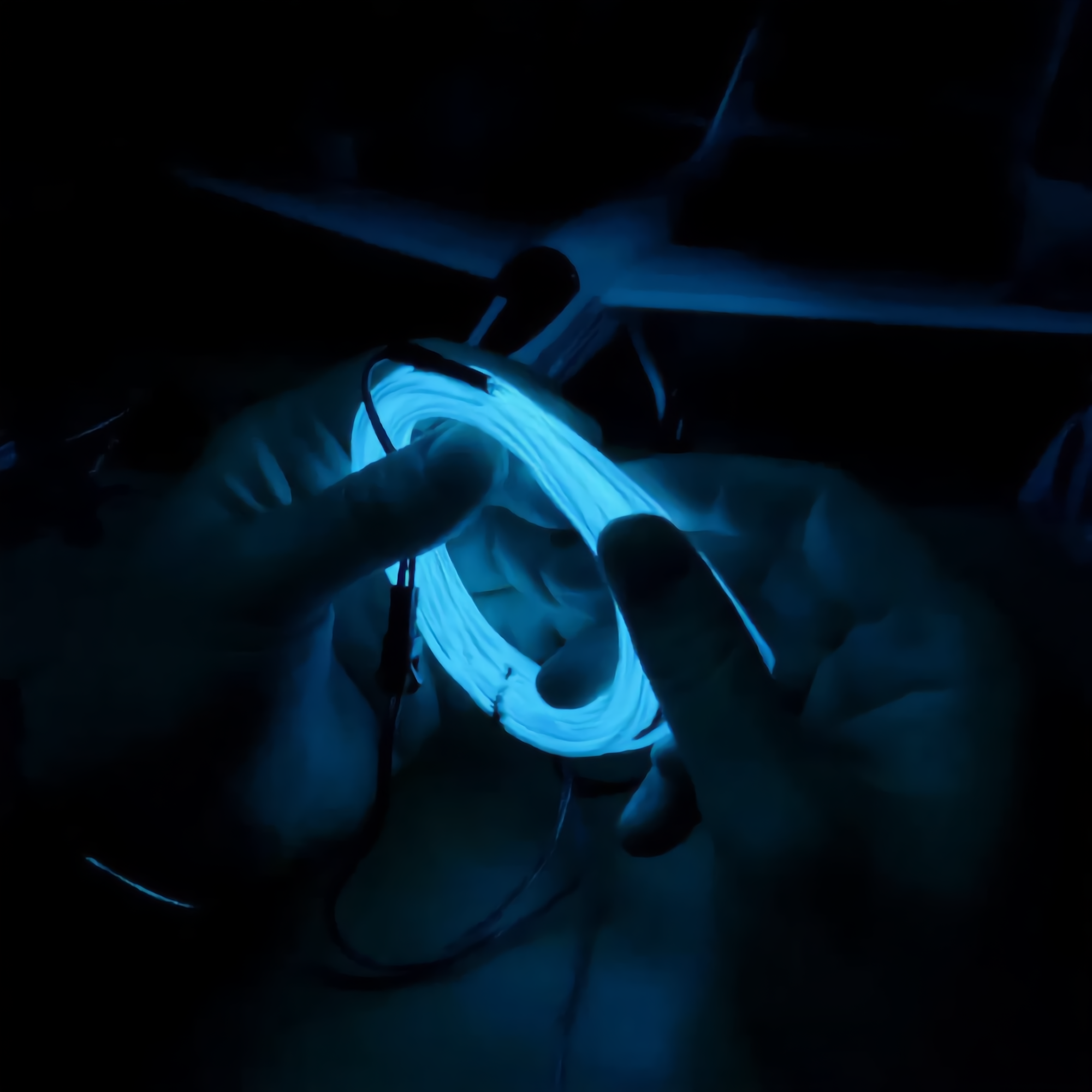

Painless360 has embarked on a quest to turn model aircraft into glowing marvels reminiscent of Tron. Why? Because night flying should be both stylish and functional—after all, nothing says ‘I’m a serious drone enthusiast’ quite like a lit-up wing. The secret weapon here is EL Wire, which offers low-drain lighting that lets you keep your UAV visible without the battery-sucking antics of conventional lights.
In true British fashion, however, there’s a catch: while EL Wire is cool to the touch and works a treat when embedded in foam, it comes with a high-pitched inverter that might just play havoc with your GPS. Painless360 recommends testing this little rascal before you start snipping away at your foam wings. After all, the last thing we want is your aircraft performing a disappearing act mid-flight due to some electromagnetic interference.
The installation seems straightforward enough—cut the wire, seal the ends with hot glue, and keep the inverter at a distance from sensitive bits. For those who prefer a more pixelated approach, LEDs do offer brighter options, but you’ll pay for that in battery life and warmth. So, what will it be? Glow or go home?
In summary, if you’re keen to illuminate your night flights with a dash of flair, give EL Wire a go. Just remember: test before you nest.
