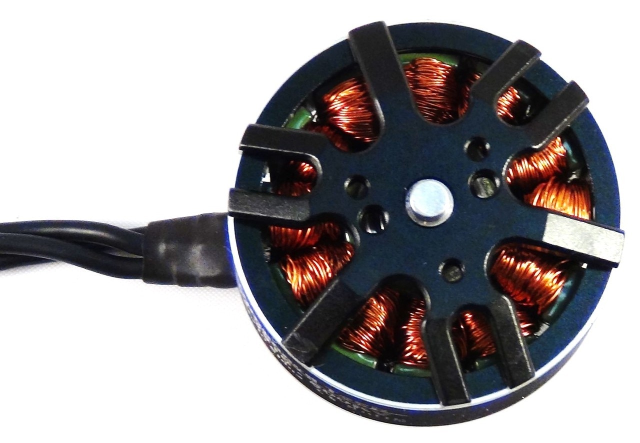

hello i have taror tyi-5008 400kv motor for quadcopter. its maximum current is 24A for 15 inch prop. i have used 30A esc but esc get busted.
Sometimes ESC can fail for other reasons, or even something like the motor jamming with the ground in a crash can cause an ESC to burn out tooā¦ Lastly Did you use the correct voltage with your motor and ESC?
