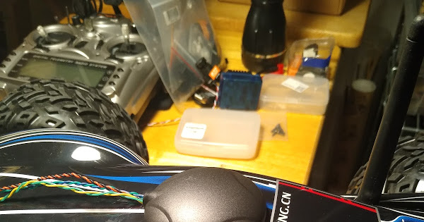

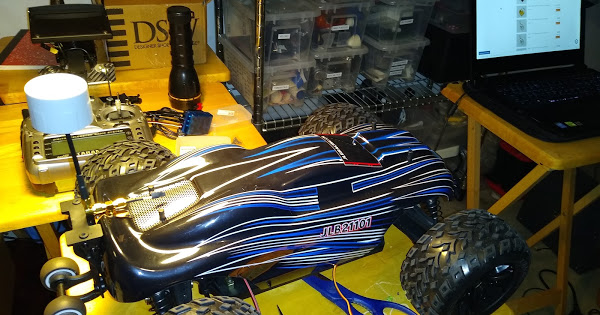

Hey bud, start with Pawel Spychalski on YouTube. Become a Patreon, and support him. He has modified iNav for rovers. Now it accepts reverse, two axis pan tilt. My JLB Cheetah is a work in progress. I’m about to devote all my time to it, but I’m finishing up 3 copters at the moment. I’ll get there…
