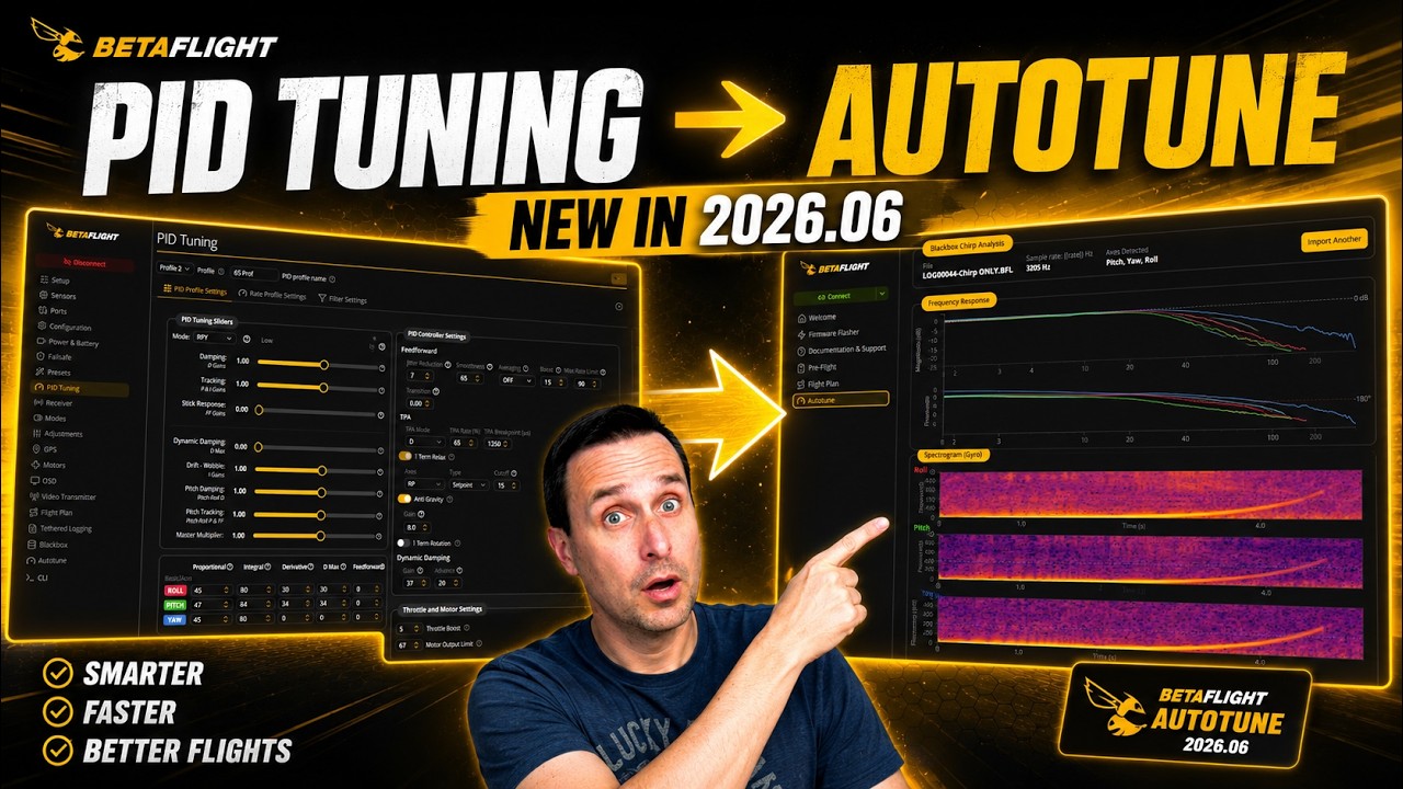

Betaflight has decided to dabble in the perilous world of autotuning with its latest feature, currently residing in the master branch for 2026—because who doesn’t love a good beta adventure? While it’s got potential as an analysis tool, the PID recommendations are decidedly more ‘meh’ than magic just yet. So, if you’re thinking about blind faith, it might be worth reconsidering your life choices.
To get the most out of this new fangled tool, you’ll need to ensure a few things are set up before you launch into the skies. The chirp mode must be enabled during flashing, and a suitable switch assigned, or else you might as well be flying a brick. And just for fun, make sure you’re in debug mode with chirp logging activated—because nothing says “professional pilot” like scrambling to configure Blackbox settings right before take-off.
While the graphs provide some valuable insights into your quad’s behaviour (and they genuinely look pretty), the auto-applied PID adjustments can leave you wishing you’d stuck with manual tuning. One notable blunder even suggested zeroing pitch gains—an innovative way to ensure your drone doesn’t take off at all. So, a word to the wise: treat those recommendations with the same caution you’d give to a dodgy curry on a Friday night.
In summary, consider using Betaflight Autotune for its analytical prowess rather than a one-click solution to your tuning woes. For seasoned pilots, it’s a nifty resource; for the less experienced, we suggest keeping your understanding of P, I, and D close at hand while you navigate this undercooked feature.
