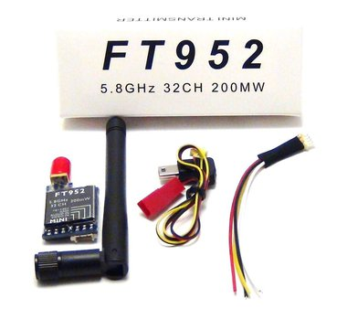

I recently purchased some Fatshark FPV goggles and before I order a FPV transmitter, I just wanted to check if the FT952 FPV TX will work with my fatshark goggles?

This will mainly depend on what receiver you are using with your fatshark goggles. The standard frequency of fatshark transmitters/receivers is on the airwave band so the main channels that you can use is on the Airwave band is: 5740MHz, 5760MHz, 5780MHz, 5800MHz, 5820MHz, 5840MHz, 5860MHz. Some of the newer ones support more channels however so if you can let me know the exact transmitter you are using I can help.
As for the frequency range of the FT-952, is all 32CH on the 5.8Ghz frequency, so it does also support the airwave frequency band so it should work on band d which is the airwave FPV band.
Hope that helps
