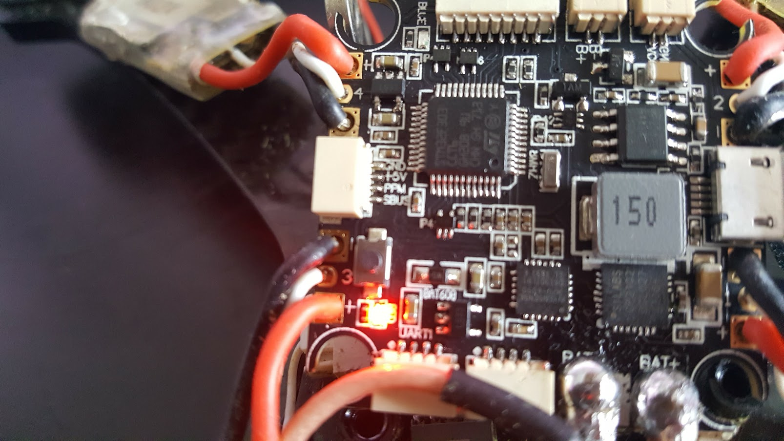

Yes, the led in the image attached is the one that lights up. Its lighting sequence is: 3 fast flashes, followed by 2 slower flashes. This repeats continuously.
when I connect the battery, the motor sequence starts, beep-beep-beep, then nothing. It does not finish the rest of the sound sequence as I remember…
The red led goes from flashing sequence above to very lightly on. You can JUST about see that it’s emitting red light.
