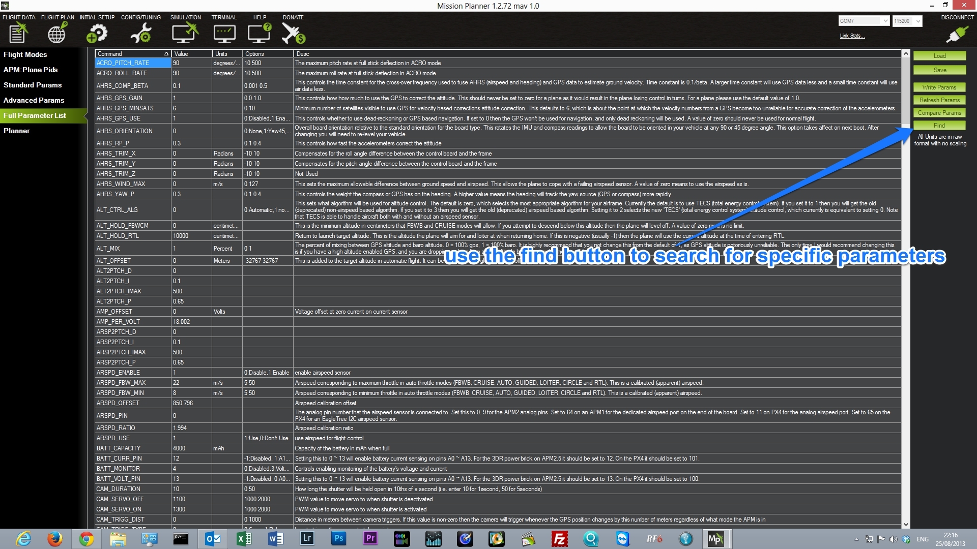

I suspect these settings are in the advanced parameters, correct? The APM Wiki doesn’t mention where to look.
Can anybody make sense of them? If so, can you explain what I need to change?
